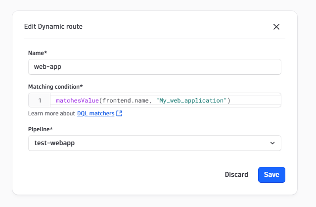

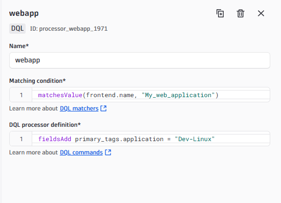

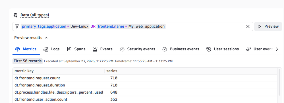

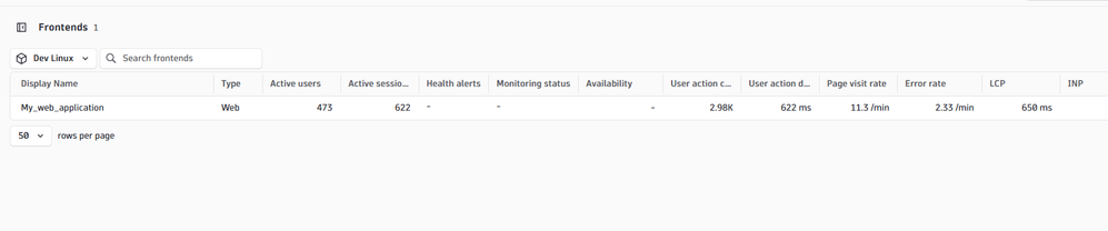

Hi @suraj_gupta3
Frontend/RUM entities didn't automatically appear in my segment when using Host Group based primary tags. To include Frontend data in the same segment, add an OpenPipeline processor that assigns the same primary_tags.application value to User Session data based on frontend.name. This allows both infrastructure and frontend telemetry to be accessed through a single segment (Dev-Linux).
Steps below---
Settings → Process and contextualize → OpenPipeline → User sessions
Create a custom pipeline (e.g. webapp)
Create a routing rule that sends matching sessions to the custom pipeline.
Segment Definition — Use OR Condition
Settings → Environment segmentation → Segments
