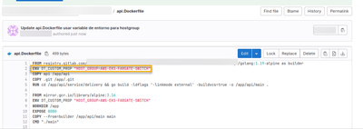

  1. No matter what option you selected to create the container please add an Enviroment Variable in your dockerfile.
ENV DT_CUSTOM_PROP "Host_Group=AWS-EKS-FARGATE-SWITCH"​
example:
  • As you see in STEP 1 after ENV use DT_CUSTOM_PROP
  • And finally set your Environment Metadata "Host_Group=my_host_group" in my example "HOST_GROUP=AWS-EKS-FARGATE-SWITCH"
  • After this please deploy your Fargate container.
