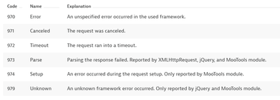

I have an application that started showing a lot of HTTP/971 error codes. Never had heard of these HTTP codes, looked online, didn't find anything.
Then I found in the UI that it referred to "Canceled". After some more searches, found a page in the documentation, in that these errors are specific to Dynatrace RUM 🙂
https://www.dynatrace.com/support/help/how-to-use-dynatrace/real-user-monitoring/setup-and-configura...
They are the following:
They can be configured to not affect Apdex, which they do by default in Applications created after version 1.238

Dynatrace documentation:
For applications created with Dynatrace version 1.238+, the RUM JavaScript reports some request errors using custom status codes 970–979 when the real HTTP status code can't be captured. Note that these custom status codes are not real HTTP status codes; they just mean that the RUM JavaScript detected an error fired by the framework you use.
