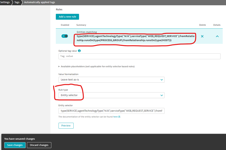

1.     Auto tag all Opaque Services
We’ll define auto tag for capturing all services that is
  • Not external, so we’ll add to the entity selector that our service must be running on process group that’s hosted on monitored host.
  • Agent technology is missing and this is the Opaque service indicator, accordingly we use agentTechnologyType(“N/A”) in our entity selector query
This is the entity selector query below:
type(SERVICE),agentTechnologyType("N/A"),serviceType("WEB_REQUEST_SERVICE"),fromRelationship.runsOn(type(PROCESS_GROUP),fromRelationship.runsOn(type(HOST)))

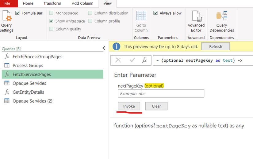

Finally you can focus on FetchServicesPages and press invoke without entering the nextPageKey as it’s optional parameter as shown below.
