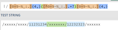

      delimiterOrRegex_mid: '[0-9-%_:.]{4,}([^0-9-%_:.].*?)[0-9-%_:.]{4,}'

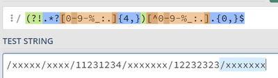

      delimiterOrRegex_end: '(?!.*?[0-9-%_:.]{4,})[^0-9-%_:.].{0,}$'

3 - [0-9-%_:.]{4,}([^0-9-%_:.].*?)[0-9-%_:.]{4,} detect TEXT between number:
4 - (?!.*?[0-9-%_:.]{4,})[^0-9-%_:.].{0,}$ detect text after number(it was the most difficult part to write!):
If there is only one number in URL rule number 3 would not return anything.
