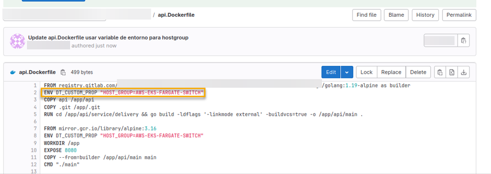

If you want to monitor AWS Fargate with Dynatrace and deploy OneAgent you have three options according to your scenario:
As you may notice the parameter:
--set-host-group=my_host_group
is not supported in Fargate but for many of us this is a gruesome headache because we use hosts groups for many purposes like assigning membership to MZ's among others.
But the following guide is a step by step solution to resolve this using a workaround.
ENV DT_CUSTOM_PROP "Host_Group=AWS-EKS-FARGATE-SWITCH"
example:

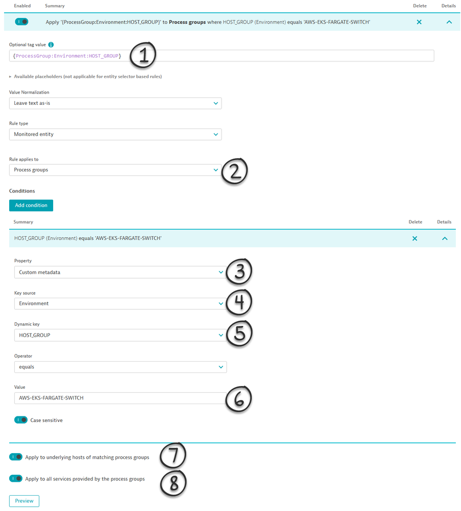

Please pay attention to the options on the numbers 1 to 8.

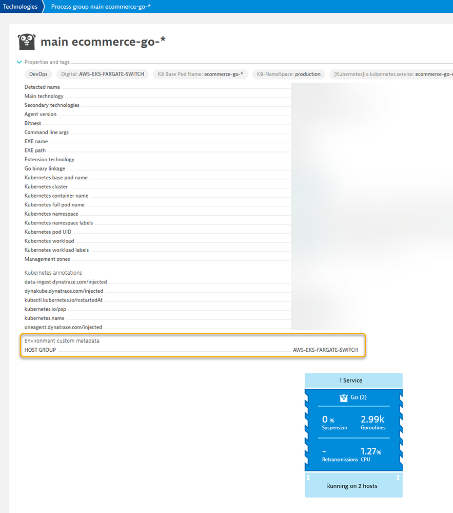

Hi @DanielS , first of, gracias por tu solución!!
But I am facing an issue.... We have some containers that perform similar tasks, with the same kind of process, but for different apps, that are build for different purposes.
So we have added the "ENV DT_CUSTOM_PROP "Host_Group=APP01" for one app, and "ENV DT_CUSTOM_PROP "Host_Name=APP02" for a second app.
We can see the custom metadata at the process instance entity as it should be, APP01 for one and APP02 for other. But since they don't have a hostgroup and the process are the same tech/version, they have the same ProcessGroup, and at the PG entity, it have a random value for the custom metada, and the Autotag rule ends up getting the wrong value.
Setting different metadata Key also don't solve this issue, since the PG ends up with all the custom metadata, and again the auto tag rule gets the wrong value, in fact, it gets all of them.
Do you faced this same behavior at your side?
Any idea on how to sort this out?
The idea is to easy find the respective app at the service list.
Thanks.
15 Jul 2025 04:49 PM
Hello @dannemca I'm happy to help, mi amigo.
Look at the following config under Process Group Naming:
Do you think it could help you? Pls, let me know.
23 Jul 2025 06:37 PM - edited 23 Jul 2025 06:39 PM
That will just rename the PG, but it will not define the grouping. I tried to create a simple detection rule too, using the custom env as identifier, but it did not worked...
I am trying with support chat for support on this.
Some of my containers are not getting the default AWS properties during the oneagent start, and this is causing the messing with the process grouping.
Gracias, amigo.
edit: I forgot to mention that I could sort out the auto tagging issue, using the entity selector with from/to relationship, since the process instance are getting the right tag based on the custom metadata value.
