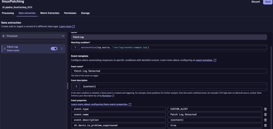

When we see a log line that comes from patch log file, we create a Davis-event from OpenPipeline with this configuration.
Make sure of adding the last property dt.davis.is_problem_suppressed so as to avoid the problem noise. Whenever you get a log line detected in the Patch log this pipeline would be triggered and create a davis event.

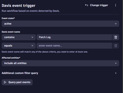

Next part is extracting this and converting it to Bizevents.
Create a new workflow with the Davis event trigger. In this case it would go like this.
