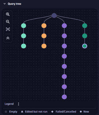

Great app ! And personally, I like the query tree feature to navigate through your query history.
The feature should be integrated in notebooks too !
Thx
