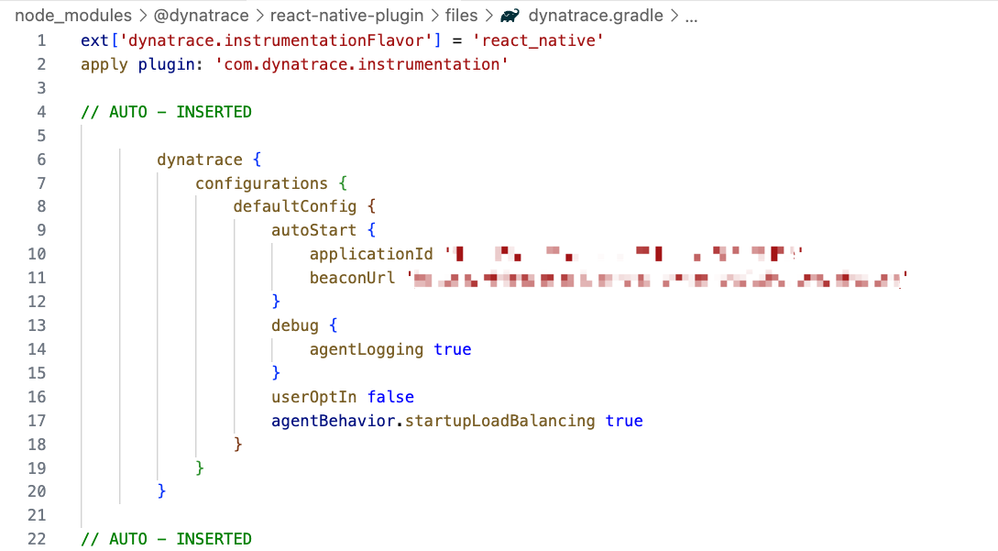

Once you have run the command, you can view the configuration from the dynatrace.config.js in its respective OS folder:
For Android:
You should be able to see the changes in the dyantrace.gradle
{project name}/node_modules/@dynatrace/react-native-plugin/files/dynatrace.gradle

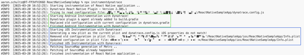

Once the command npx instrumentdynatrace has been ran, you can view the change from the terminal:
If you made changes and it was successful:
You should be able to see that for both OSs, that the configuration has been updates
The green box for Android
#INFO  [2025-03-20 16:52:25]: Starting Android Instrumentation with Dynatrace!
#INFO  [2025-03-20 16:52:25]: Dynatrace plugin & agent already added to build.gradle
#INFO  [2025-03-20 16:52:25]: Replaced old configuration with current configuration in dynatrace.gradle
#INFO  [2025-03-20 16:52:25]: Finished Android Instrumentation with Dynatrace!
The blue box for iOS
#INFO  [2025-03-20 16:52:25]: Starting iOS Instrumentation with Dynatrace!
#INFO  [2025-03-20 16:52:25]: Generating a new plist as the current plist and dynatrace.config.js iOS properties do not match!
#INFO  [2025-03-20 16:52:25]: Removed old configuration in plist file: /Users/aaron.schultz/MyApplications/Mobile/React Native/ReactNativeSampleApp/ios/ReactNativeSampleApp/Info.plist
#INFO  [2025-03-20 16:52:26]: Updated configuration in plist file: /Users/aaron.schultz/MyApplications/Mobile/React Native/ReactNativeSampleApp/ios/ReactNativeSampleApp/Info.plist

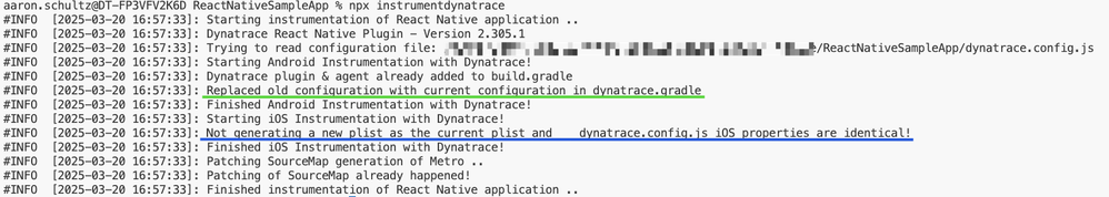

If no changes were made to the dynatrace.config.js
For Android, the gradle file will be written, but since nothing change, the output will be the same.
For iOS, the plugin is aware that the p.list is the same and does not make any further changes to the p.list
