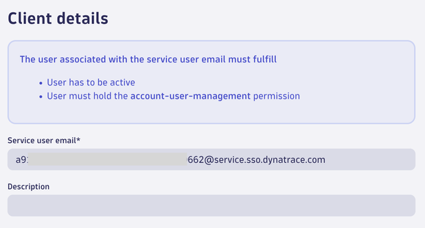

Monaco requires an OAuth Client to work. So I wanted to create an OAuth Client for a service user. When you do that via the UI you will be challenged by this message:
The problem is that you cannot easily assign the "account-user-mangement" permission to a service user. If you try to edit the service user you will not get this permission listed to add it (likely because it is a account permission with no policy available?).

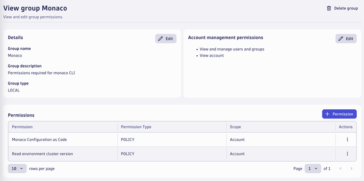

First: create a group "Monaco" assign it account permissions and bind some policies to it:

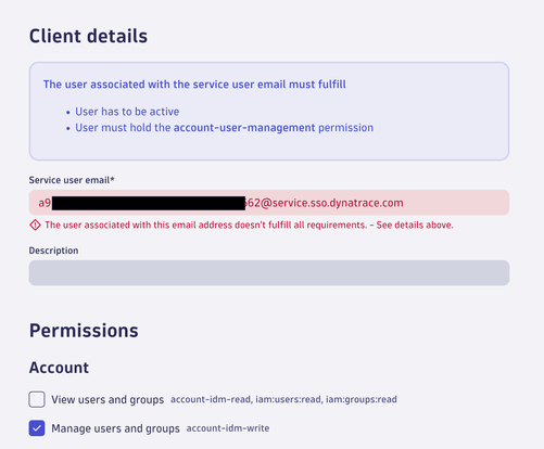

Now the service user has the required permissions so that we can create a OAuth client for it. The UI will not complain about missing permissions of the service user:

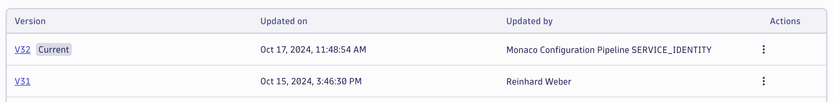

And you can now change your Monaco setup to use the new service user OAuth client. Any configuration change will now be recorded as done by the service user instead of any personalized account:
