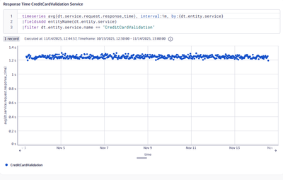

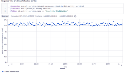

Mini Demo: Let us start off easy with a scatterplot of one metric (y-axis) against the timeframe (x-axis), so a metric over time. This is a nice alternative to line graphs.
timeseries avg(dt.service.request.response_time), by:{dt.entity.service}
|fieldsAdd entityName(dt.entity.service)
|filter dt.entity.service.name == "CreditCardValidation"
If I select a bigger timeframe now, Dynatrace will adjust the interval, meaning that many datapoints will be merged to one. I am not keen on that, as it defeats the purpose of a scatterplot which is supposed to show all datapoints, but we can avoid it by adding an interval ourselves Like that:
timeseries avg(dt.service.request.response_time), interval:1m, by:{dt.entity.service}

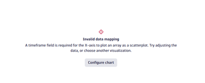

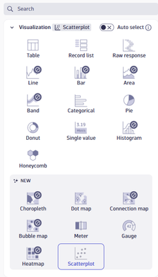

Unfortunately, we cannot choose the scatterplot visualization immediately. I actually would have liked that… so we will go for a workaround to make it possible. This is not documented in the release notes or in the Dynatrace Documentation so feel free to follow my steps.

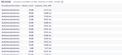

We need to look at a record list, and no longer at two timeseries. The following commands will convert the timeseries to single records:

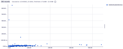

// Expanding timeseries to single records |fields all = iCollectArray(record(response_time_p99= response_time_p99[], request_count = request_count[])),dt.entity.service.name |expand all |fieldsAdd request_count = all[request_count], response_time_p99 = all[response_time_p99] |fieldsRemove all
Result:

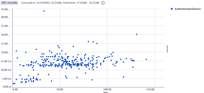

Now it makes sense to remove the outliers (a boxplot would be great now to know which ones to exclude, but that feature does not exist in Dynatrace yet). So, we add the following rules (based on the visual impression of outliers):
//Removing outliers |filterOut request_count > 150 //(number of requests) |filterOut response_time_p99 > 100000 //(100ms)
The amount of requests per minute seems to have a positive relationship with the response time of the slowest 1% requests (more requests are related to a higher response time).

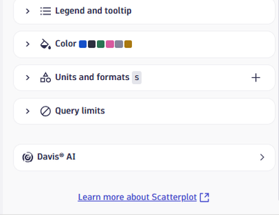

My 2cts: Mostly happy about the feature. More dashboarding options and more data science is always a good step forward. I do miss the option to add a trendline (see the example with R).
For me, this belongs to a good scatterplot. Unfortunately, there is also no documentation page for scatterplots so far, so the link from the DQL tile does not work yet:
Furthermore, it is not possible yet to simply add two timeseries and turn them into a scatterplot with a normal metrics tile or DQL tile without intermediate steps (see the error message). That could be improved in the future to make this feature more accessible to everyone.

I just tested and apparently now, simply creating two timeseries is now allowed for a scatterplot, so this was a nice workaround, but it is not necessarily needed anymore. 🙂 Both ways work now.
So now you could simply create a DQL tile with
timeseries {response_time_p99 = percentile(dt.service.request.response_time, 99),
request_count = sum(dt.service.request.count)},
interval: 1m, by:{dt.entity.service}, union:true
|filter dt.entity.service == "SERVICE-1234567891011"and switch to a scatterplot visualization immediately. Nice improvement to make it more user friendly.
