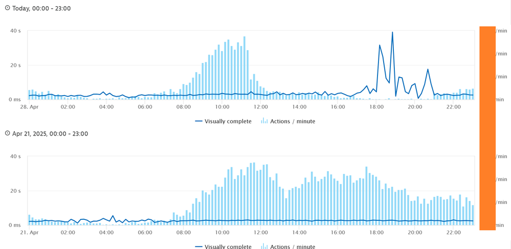

  3. Users were hit harder. In today's world, where a lot work remotely, chances of using fixed network technology was almost certainly gone. Almost all RUM graphs I have seen are like this (yy axis excluded for data protection):
  4. Traffic went down quite fast at 11:33, but not all. So servers/applications are good, but users are gone. And at the end of the afternoon, (what I suppose are the difficulties I also sensed) much higher times started appearing, with almost all users gone.
  5. With Dynatrace, you can easily compare this with a previous timeframe

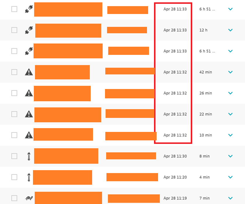

  6. And yes, Davis was quick on the diagnosis. And lot's of "Unexpected low traffic", although not as much as I initially felt would happen. This seems to have happened because Easter Monday, last week, is typically a day off for a lot of Portuguese.AntonioSousa_1-1745883203358.png

How can we explain the rise of the visually complete time a few hours after the blackout and with no significant user traffic?
Frontend servers where pulled out from clusters to save energy causing performance degredation, is what comes in mind.

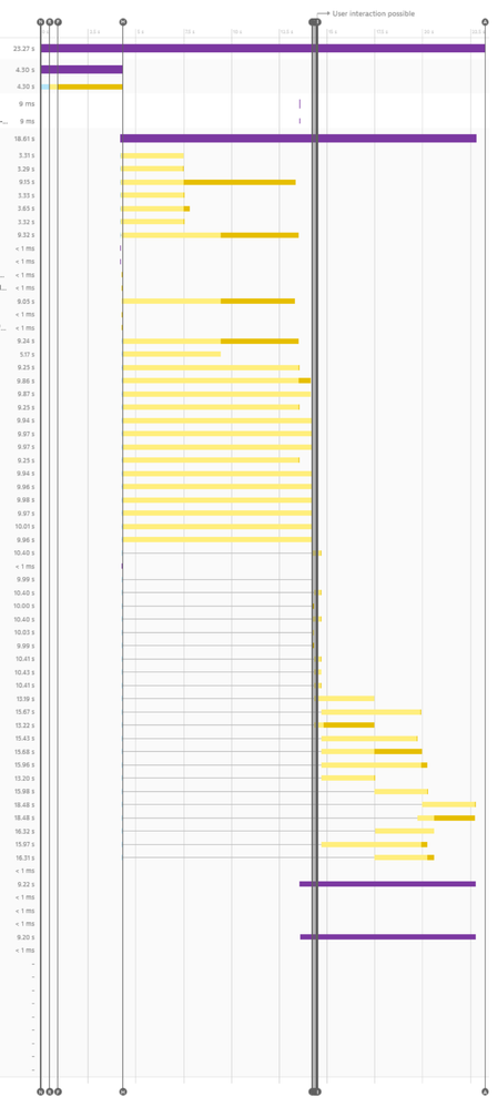

I experienced it first hand. It was on the client side, as the few that still had Internet access (like me) were in probably one of the following situations:
  • Low battery power, so it takes the browser more time to process
  • Mobile operators started having difficulties, and even rate-limiting bandwidth
This can be easily seen in the waterfalls. Notice the long First Byte and download times. The quick objects are 1ms, served through cache (importance of caching!). Synthetics also showed sites downloading fast, all through the event 🙂

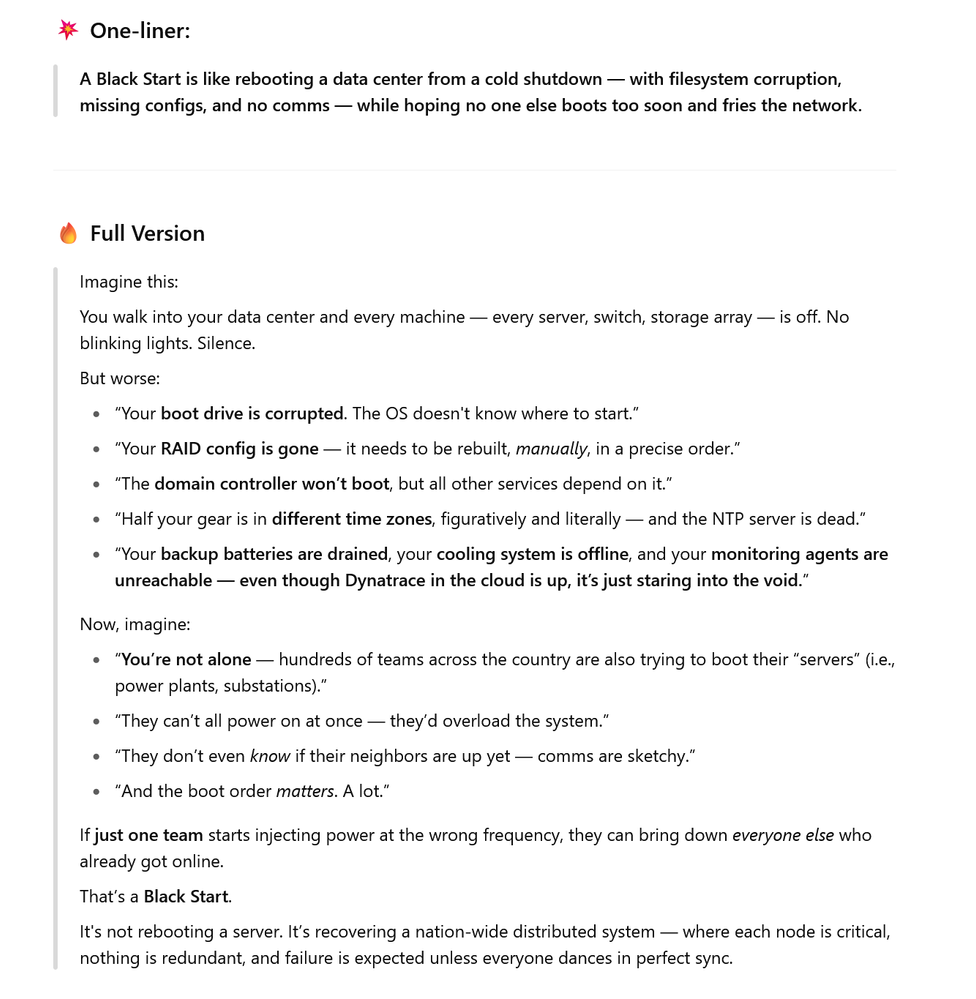

24 hours after, I just can't get enough of what me & ChatGPT have been discussing about what would be a good analogy of what a Black Start is for the Energy teams, seen from an IT perspective. This is what we came up with 😂:
