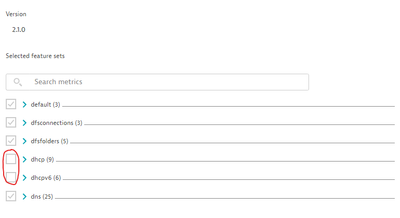

@travis_anderson  I had similar problem and found that I didn't have DHCP server on host. Check it.
And if you don't have DHCP just turn off checkbox with DHCP metrics.
