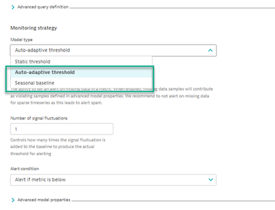

Hi @bill_scheuernst, I would suggest taking a look at creating a metric selector-based metric event:  https://docs.dynatrace.com/docs/shortlink/metric-events-metric-selector-events
In there, you will have the option to leverage Auto-adaptive threshold and Seasonal Baseline, which works similarly to adaptive thresholds and baselining for services.
