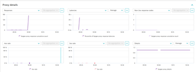

Currently, the extension is classifying HTTP 201 (Created) responses as errors, directly impacting the Failure Rate metric.
The Issue
As per the RFC 7231 HTTP standard, any 2xx series code indicates a successful request. Specifically, a 201 Created status means the request has been fulfilled and has resulted in one or more new resources being created. It is not a failure.
As you can see in the screenshot below, during a period where all actual error codes (500, 502, 504, 400, etc.) are at 0%, the Failure rate chart matches the exact percentage of the 201 responses (2.64%).

⚠️ Potential Design Issue / RFC Compliance Concern
I agree this is a significant design issue from an observability and HTTP standards perspective. Treating HTTP 201 (Created) responses as failures contradicts the RFC definition of the 2xx class, which represents successful requests.
I believe this deserves visibility from the Dynatrace product engineering teams, as it can directly impact SLA/SLO calculations, alert accuracy, and enterprise operational reporting.
jmoscoso
Frequent Guest
The Dynatrace platform has the following query
(cloud.gcp.apigee_googleapis_com.proxyv2.response_count:filter(eq("dt.entity.cloud:gcp:apigee_proxy",CUSTOM_DEVICE-0F572E2AE3542842)):filter(ne(response_code,"200")):splitBy("dt.entity.cloud:gcp:apigee_proxy"):value:default(0)/cloud.gcp.apigee_googleapis_com.proxyv2.request_count:filter(eq("dt.entity.cloud:gcp:apigee_proxy",CUSTOM_DEVICE-0F572E2AE3542842)):splitBy("dt.entity.cloud:gcp:apigee_proxy")*100):setUnit(percent)
where the solution is to change the query from :filter(ne(response_code,"200")) to :filter(not(prefix(response_code,"2")))
rgarzon1
Champion
This fix was deployed in version 1.339 but omitted from the original notes
