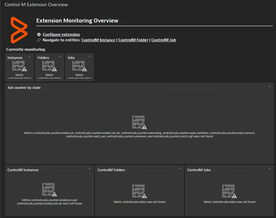

Hey everyone, I need some help with the Control-M extension. I want to monitor jobs that have ended with a status of "Ended not ok" in Control-M and display this information on a dashboard and create an alert for it.
I noticed that Dynatrace has an extension that does "exactly" that, but the documentation is terrible and poorly explained. In the first field, it asks for an API URL. But which API should that be?
I pointed it to the URL of my environment, and it says the integration status is ok, but it's not providing any information. Can anyone help me with configuring this?
Below are the attachments stating the status is ok, but I can't get information about anything.
I would just like an indication of which URL this would be and where to get it.

Please run the activegate diagnostics. Then checking logs control-m extension.
And after running, where are the logs?

In the extension, it asks me for a URL. What URL would that be? Would it be the URL of my API?
Example:
https://{my-endpoint}/automation-api/
If so, I need to provide login, password and a token to pull these logs. However, Dynatrace does not accept me configuring this in the extension's JSON.
How could I do this?
