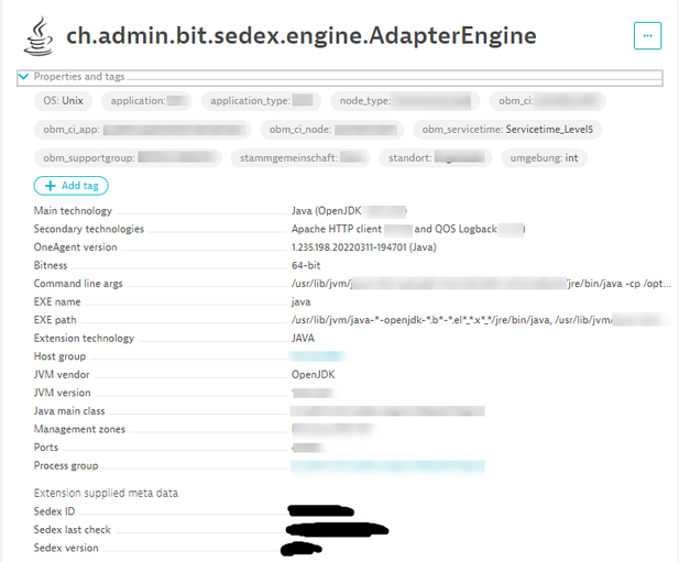

We have create an OneAgent extension which gathers additional information for a java process from a remote location. The extension works fine and the metrics are collected and available unter the Metrics Explorer.
Issue

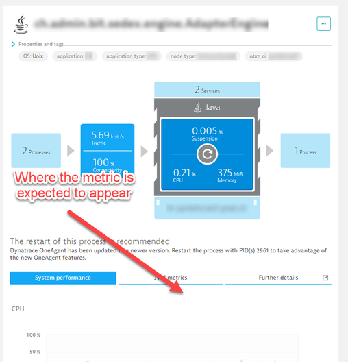

The metrics are not displayed under the process instance.
Other information such as Extension supplied meta data is displayed:

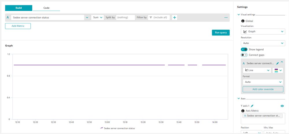

The metrics are available through the Metrics Explorer

@patmis In your first screen cap, you'll need to click the tab "further details" that will expand out all the metrics including your new custom metrics that you can see in the data explorer.
-Chad
