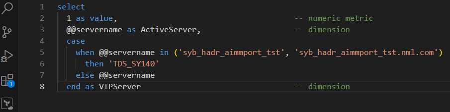

I have another issue . I want to customize my query passed in yaml . it should read from connectionstring  that is passed and return a value .
Currently it the query is
select count(@@servername) as 'ActiveServerCount', @@servername as
        'ActiveServer
 I want to do something like this . Read from connection string , if the hostname is for example - 'syb_hadr_aimmport_tst.nml.com' then return 'TDS_SY140'
Something similar to below -
select count(@@servername) as 'ActiveServerCount', @@servername as 'ActiveServer , <read from connection string . if hostname is  syb_hadr_aimmport_tst.nml.com return the value as 'TDS_SY140' as 'VIP server' >
Hi @Das-Niharika
Thanks for the update — great to hear it worked after removing GO. And yes, metrics must come from a numeric column; strings should be mapped as dimensions.
About “reading from the connection string”: the SQL running on Sybase can’t see the JDBC URL used by Dynatrace. That lives on the client side, not inside the database session.
The SQL alone isn’t enough. In JDBC extensions, Dynatrace requires at least one numeric column to be explicitly mapped as a metric; string columns must be mapped as dimensions. Without that mapping, the group executes but produces no metrics.
sujit_k_singh
Champion
@Das-Niharika
can you try this, SQL + mapping
Mapping
metrics:
  - key: "sybase.vipserver"
    value: "col:value"
dimensions:
  - key: "active_server"
    value: "col:ActiveServer"
  - key: "vip_server"
    value: "col:VIPServer"
