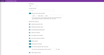

Pls see if this Synthetic monitoring option works for you.
https://www.dynatrace.com/support/help/shortlink/http-monitor#create-an-http-monitor
Does anyone know whether that would work for browser/clickpath monitors? At least based on my quick testing, an invalid cert didn't show the clickpath as unavailable. It's strange in a way that browser monitors are the more advanced ones (and expensive regarding DEM consumption) but appear to be missing the certificate check feature?

Hi All,
You can now check SSL certificate expiry directly from Dynatrace synthetic HTTP monitors.
As of cluster version 1.2.12
This native addition is great to see but is there any way we could work with DT to enhance it a bit more.  For example instead of just saying XXX days until expiration it would be great to see what the certificates actual expiration date and time are, i have a few use cases explaining why this would avoid confusion and could share in a conversation.  Another issue is this type of Synthetic has a 60 minute max limit but we only want to do cert checks every 12 or 24 hours.
HigherEd
during configuration it says it requires ActiveGate 1.235 for private locations, but how do I set this to work from ActiveGate? Seems like it works only from some cities around the world and it's not possible to check internal site which is not publicly accessible.
