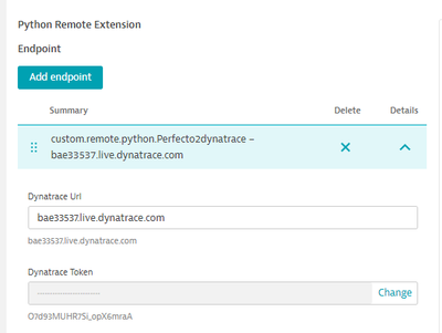

Here is a part of activationShema.json with text and secret entries
Here is how the entry look from the end point definition side
And here is the the part from __main__.py that collect the information from the endpoints
HTH
Yos

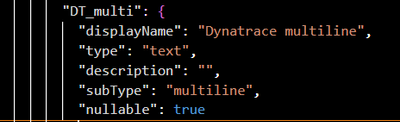

Hi @Roeir5
Stand corrected
Please try if the follows solve your need
Yos
