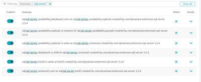

Topology can be different depending of SQL extension version. Maybe it was updated in a release. I would recommend checking topology relationships in your environment:
Best regards
I've reviewed the settings and topology of my SQL Extension:
type("sql:sql_server_availability_replica"),fromRelationships.isSameAs(type(sql:sql_server_instance),fromRelationships.runsOn(type("sql:sql_server_host"),fromRelationships.isSameAs(type("HOST"),tag([Environment]Application:NAME))))
should work, but I don't get any entity.

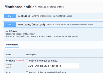

I just checked it and we do indeed get the proper data from the relationship-based entity selector. I would recommend to check the relationships for your replicas via the API. You can open up the replica you're looking at, copy the custom_device ID and use it in the monitored entities API with the GET /entities/{entityId} API to see the relationships that are present in your environment.
