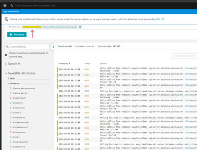

Another advantage of extensions v2 is that the logs are shown in Logs and events

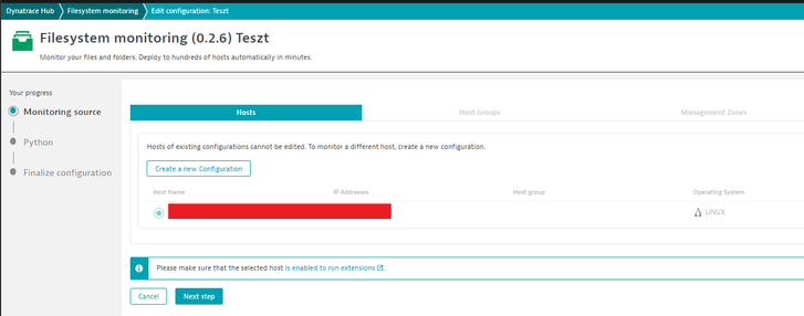

I think the filesystem monitoring extension is a OneAgent extension because there is no possibility to choose an AG group, just host, hostgoup, MZ, or ENV.

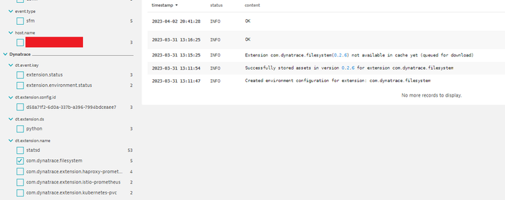

And there are limited logs that can be found in Log Viewer, almost nothing about the operation of the extension just the extension registration (however debug log level was set):

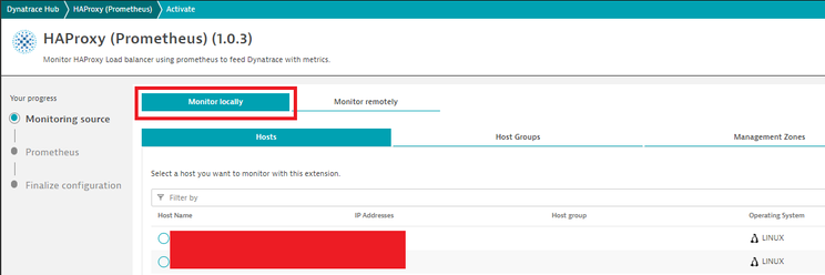

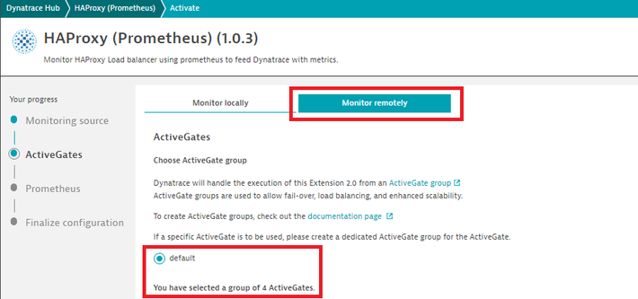

I have checked another extension also which has two options OneAgent or AG extension.
local OneAgent similar to the filesystem extension
or remote AG extension:
I guess regarding the filesystem extension I have to search the debug log on the monitored host instead of AGs.
What do you think? Am I right?

Yep @Mizső IMO you are right, look at the host under ProgramData\dynatrace\oneagent\log\extensions directory for OA extensions logs

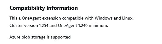

Sorry for not noticing the details. In fact, it is a OneAgent extension, as described in the Hub:
It works quite well, and we are using it in a client 😊
