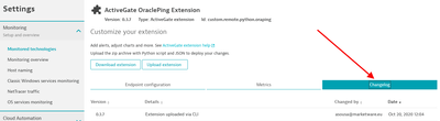

To check versioning, you can check the extension version in the Settings
and then check in the Hub if there is a newer version. I believe you could automate this through the API, but I have not done that myself.
