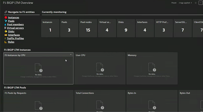

Hi guys,
Customer installed the extension (V 1.0.3 and then upgrade to V1.0.4) and we see information only at the top of the dashboard while all other tiles are empty
Also when clicking on the links the information is empty, for example instances link
The extension do pull lots of information in terms of metrics (106)
And when look into the tiles its look like the metrics are not set correctly
After rechoosing them
We do see the information
So it looks like a dashboard issue Any suggestions?

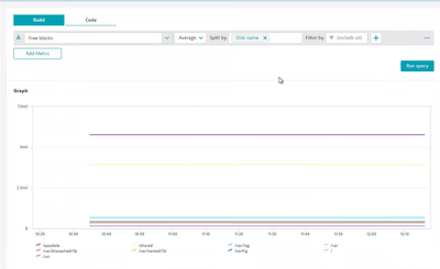

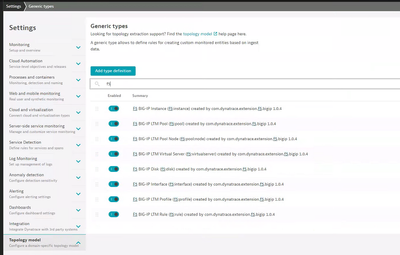

Can you share with us some screenshots of the following:
Thank you.

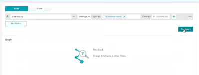

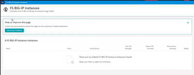

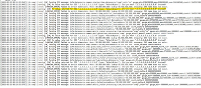

Hi @Radu
Thanks for the prompt answer!
Here it goes:
1.
2.
3.
Let me know if you need any more information
Thanks again
Yos
While the second screenshot is not splitting by an entity - I think I found the issue 🙂
The instance name (retrieved by OID 1.3.6.1.2.1.1.5.0) is the only detail that the entire extension topology depends on as it is used to uniquely identify F5 Instances and the objects running on them.
So long as the F5 device responds with values to the metric queries, the metrics will report those results (even though some splittings may be missing) - this is why you can see metrics and their data.
The top row of tiles on the dashboard removes any dimension splitting which is why these tiles also show data.
All other tiles on the dashboard will split the metrics by the primary entity they belong to. Since you're not registerding "F5 Instance name" that all entities depend on, no entities are being created, hence why these tiles are empty and also why the shortcuts send you to empty lists.

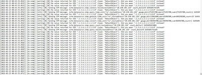

Is it possible for you to run an SNMP Get query against this device?
It would be helpful to see what comes back when querying OID 1.3.6.1.2.1.1.5.0
Hi @Radu ,
OK its looks like we are close to the root cause here ....
From extension log its shows that OID 1.3.6.1.2.1.1.5.0 return no value
Do you still need here to check the response from snmp get ?

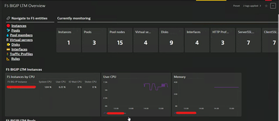

Hi @Radu
After restart of the snpmd agent on the F5 we started to see "device.name" and "device.address" dimensions for f5 metrics.
The instance name was added after some inside configuration by the F5 guy and now we see information!!
Thanks for your support !
