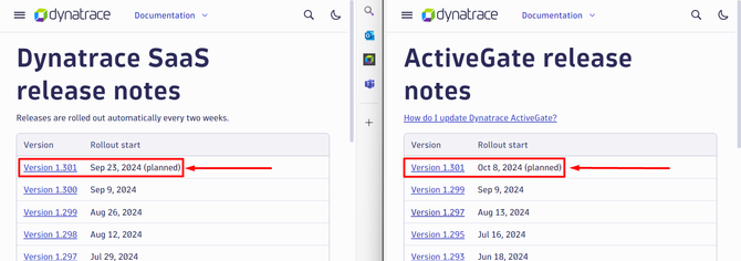

Hi Community
The link with more information about the migration to Extension Framework 2.0 is this > Unmatched scalability and security of Dynatrace extensions
The Linux Command extension will stop working from 2 Factor ActiveGate and Dynatrace SaaS
With version 1.301 of both ActiveGate and Dynatrace SaaS, this extension will no longer work.
I suggest you could create a Dynatrace ticket, so a workaround can be evaluated. 💪
I hope it's helpful 💪
