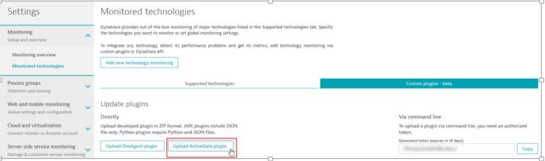

Hello everyone;
I'm trying to install the datapower plugin for Dynatrace
The documentation says that from the version Windows ActiveGate version 1.147+.
I installed the Dynatrace-Security-Gateway-Windows-1.149.165 but I don't see the button: Upload ActiveGate plugin
Soo I have add the parameter: REMOTE_PLUGIN_SHOULD_INSTALL="true"
Remote Plugin Agent service:
I'm also installing the activegate 147.186 and no have this parameter activated.
Regards.
06 Aug 2018 10:46 PM
Apparently whoever shared it with you did not enable the required feature flag. Please reach out to extensions@dynatrace.com with the url to your environment and where you got the plugin from and we will arrange it.
Kind regards,
Mike
