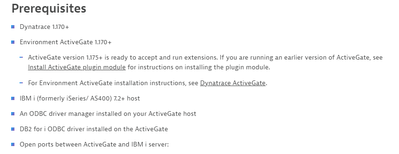

Hi all,
following the steps to integrate AS400 with Dynatrace, I'm wondering where should i unpack the db2 odbc driver.
The documentation says install the zip on: %PROGRAMFILES%\dynatrace\remotepluginmodule\plugin_deployment
Does the IBM driver go into the same folder?
link to the doc: IBM i monitoring | Dynatrace Docs
Thank you all!

As far as I can see You are planning to perform this task on Windows. Considering that extension is using ODBC driver manager then You just need to install it on Windows - it should be an installer. According to IBM docs Installer for 64bit contains both 32 and 64bit drivers.
To confirm if it is installed properly You can run odbcac32 on Your OS either by run or CMD command line and check drivers tab.

Hi @MariettaAlmeida ,
If you downloaded the correct package (Windows_AP for Windows ActiveGate, Linux_AP for Linux ActiveGate) from IBM's site, you should see a setup.exe inside the downloaded zip archive. If you install that binary file, it automatically sets up all configurations for you and places drivers in the right folders for you. After you run the executable, you do not have to do anything else with the driver. You do not place any drivers manually yourself.
The driver should be recognized by Windows first, then the extension can pick it up from the available drivers on the system. Windows driver manager does this automatically for you.
Hope this helps,
