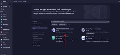

For creating custom Dynatrace extensions there is extensive documentation available here https://docs.dynatrace.com/docs/extend-dynatrace/extensions20. Under that page there are a few key areas of interest that would be most relevant for you.
Additionally there should be a custom extension creator app that currently focuses on SQL based extensions. This should allow for much easier setup and creation of an SQL based custom extension. This can be found in the hub as seen below.
Of the above I would start with the WMI extension tutorial to understand the general process and structure of what you are creating, and then from there I would look into the custom extension creator app and additional documentation provided.
Hope this helps!
