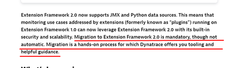

The migration of Extension 1.0 to Extension 2.0 is not automatic.
Unmatched scalability and security of Dynatrace extensions

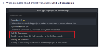

Yes, it is possible to use Visual Studio Code to perform the conversion but following some specific steps.
JMX extensions | Dynatrace Developer
That Dynatrace Developer link has a lot of information about it.
