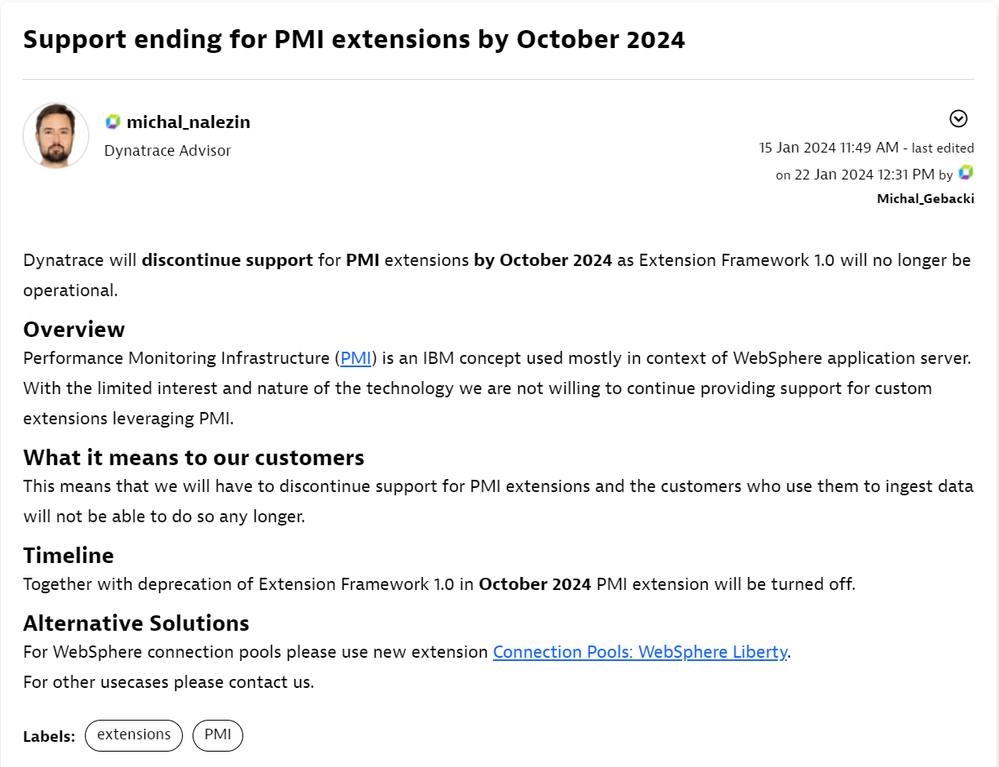

Dynatrace will discontinue support for PMI in Extension Framework 1.0 (EF1.0). We are currently working on replacement, that should be ready by end of the year. We will keep PMI EF1.0 functional until the new approach is ready and we'll provide sufficient grace period to migrate.
Performance Monitoring Infrastructure (PMI) is an IBM concept used mostly in context of WebSphere application server.
This means that PMI extensions need to be migrated around end of the 2024. Please already start planning that migration especially for custom extensions.
We do not yet have committed timeline.
For WebSphere connection pools please use new extension Connection Pools: WebSphere Liberty.
18 Mar 2024 02:12 PM
We have reassessed the approach to PMI extensions and revisited our decision on turning them off completely.
As a result this message have been edited, please find original content below.

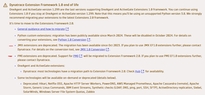

To migrate PMI extension to framework 2.0, is it possible to use "JMX 1.0 Conversion" tool from Dynatrace Extension in Visual Studio Code? I think it should because one of the PMI data collection interfaces comes from Java Management Extension (JMX) interface as it's said at the end of this page.
But reading this EOL note is not clear for me:
Could you clarify it?

04 Dec 2024 11:13 AM
Eventually that's indeed something that will be possible. For now, Extension Framework 2.0 does not support PMI, so it would not work.

04 Dec 2024 11:54 AM
The end of life of JMX and PMI in Extension Framework 1.0 has been delayed to make sure that customers get sufficient time to migrate. It will not stop working in March anymore.
