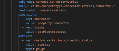

@ChadTurner yes I was able to get this working, after a few iterations. Snippet of the yaml I am using is below
mapping for it to show in data explorer
the query itself
And here is what it looks like in data explorer, splitting by the connector and status dimension
Hopefully this helps some. Definitely a learning experience for myself!
