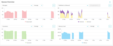

Since some days, the extension does not collect the metrics related to the queues but only the ones related to cluster, nodes and virtual hosts.
Sometimes it works again and then it stops after a while, I tried also to reboot the extension bit it does not work.
Which could be the root cause ?

I think that is an ActiveGate extension. You can check ActiveGate logs to have more details.

 Yes it is but I do not see any detail about the issue in the logs.
Which logs are you checking?

I run the active gate diagnostic from Active gate deploy status.
Yes, but have you downloaded it and check datasources logs in relation to your extension?
