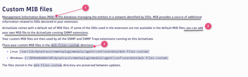

For the custom extension
Dynatrace Doc:
KR,
Peter.

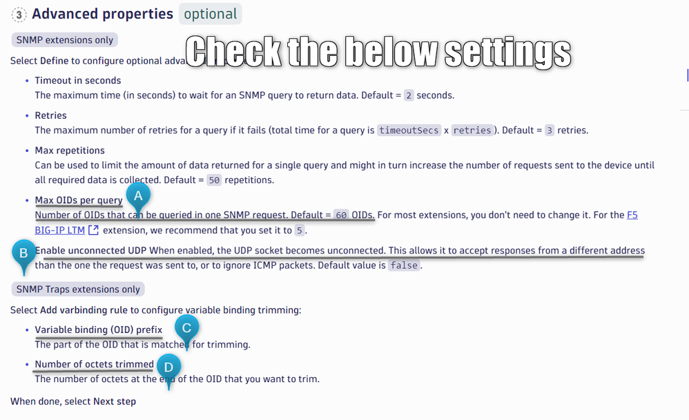

Peter_Youssef
Leader
Hello @eranga
As an alternative solution:
  • If it's possible to use the developed extension by Dynatrace from Dynatrace Hub would be good.
And in such case:
  1. Revisit citrix-netscaler-sdx.
  2. Review Citrix error-messages and configuration with NetScaler team.
  3. First of all you should validate the FW configurations are conducted properly between the assigned EAGs and the end points.
  4. Ensure the endpoints are configured properly as per app owner inputs.
  5. Disable SSL certificate check.
BR,
Peter.
