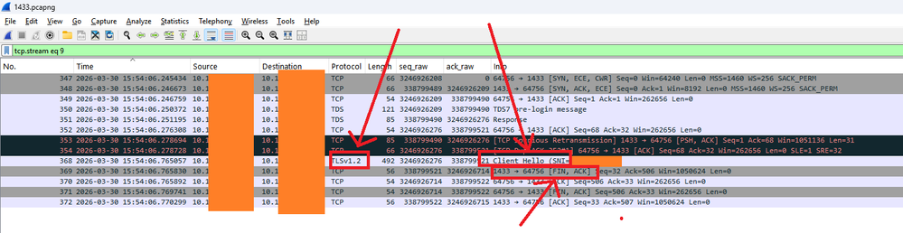

I have one case I just diagnosed where "Enable SSL" is toggled off, but nonetheless, the extension is forcing a TLS connection. Confirmed it through a network dump. What I see is that the SQL Server (in this case SQL Server 2014) is terminating a tentative TLS connection immediately:
@Mike_L , might there be something in 1.333 that forces SSL/TLS connections, despite not being told to do so? Ticket #621565
