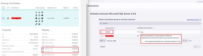

I want to use the "Activate extension Microsoft SQL Server 2.3.0" I have deployed an ActiveGate agent in one server, and after that tried to configure the extension, I checked another question talking about extensions 1 and 2 inside the AG.
As you can see in the screenshot I have both extensions and also:

This is a log I got about this error

There seems to be two issues here. One is that one of your two AG's saying that it cannot run the extension at all. If both of them look like your screenshot, then try restarting/reinstalling it and otherwise open a support case.
As for the second one, it seems like you checked to use SSL, but that you're missing a valid certificate. You can find the instructions for that here: https://docs.dynatrace.com/docs/extend-dynatrace/extensions20/data-sources/sql/microsoft-sql-monitor...
