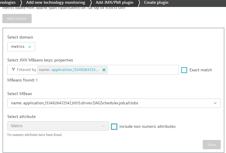

Hi Sebastian,
I think you are right, I might have not define the plugin correctly. Following way I define this. The "Select Attribute" tab was grayed so I choose include non numeric metric. This gave me warning in Yellow.
See the below screenshots. Could you please suggest what is wrong here
04 Sep 2018 01:40 PM
If you see such warning there can be nothing wrong 🙂
Including non numeric attributes results in extending available attributes list. It adds to this list also attributes which type is not numeric, that is for example java.lang.String or java.lang.Object. Dynatrace OneAgent will try then parse those attributes to Double.
User can select that attribute, and plugin will be created with this metric, but if such attribute that is in fact String will not return values that are parsable to Double, metric will not collect any data and will not be visible anywhere.
