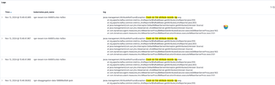

we see something similar and we opened a ticket with dynatrace for that. right now we do not know where this is coming from exactly. this is what we see:
2024-08-09 09:28:29.877 [33m WARN[m [35m7[m --- [iceventsmanaged] [36mo.a.k.c.m.JmxReporter [m : Error getting JMX attribute 'records-lag-avg' javax.management.AttributeNotFoundException: Could not find attribute records-lag-avg

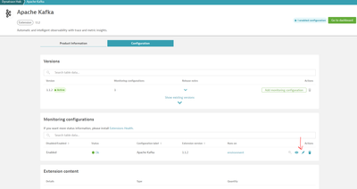

Update @erh_inetum @alain_vonallmen ,
I've managed to find a way to disable these 🙂
The above fixed it for us.
