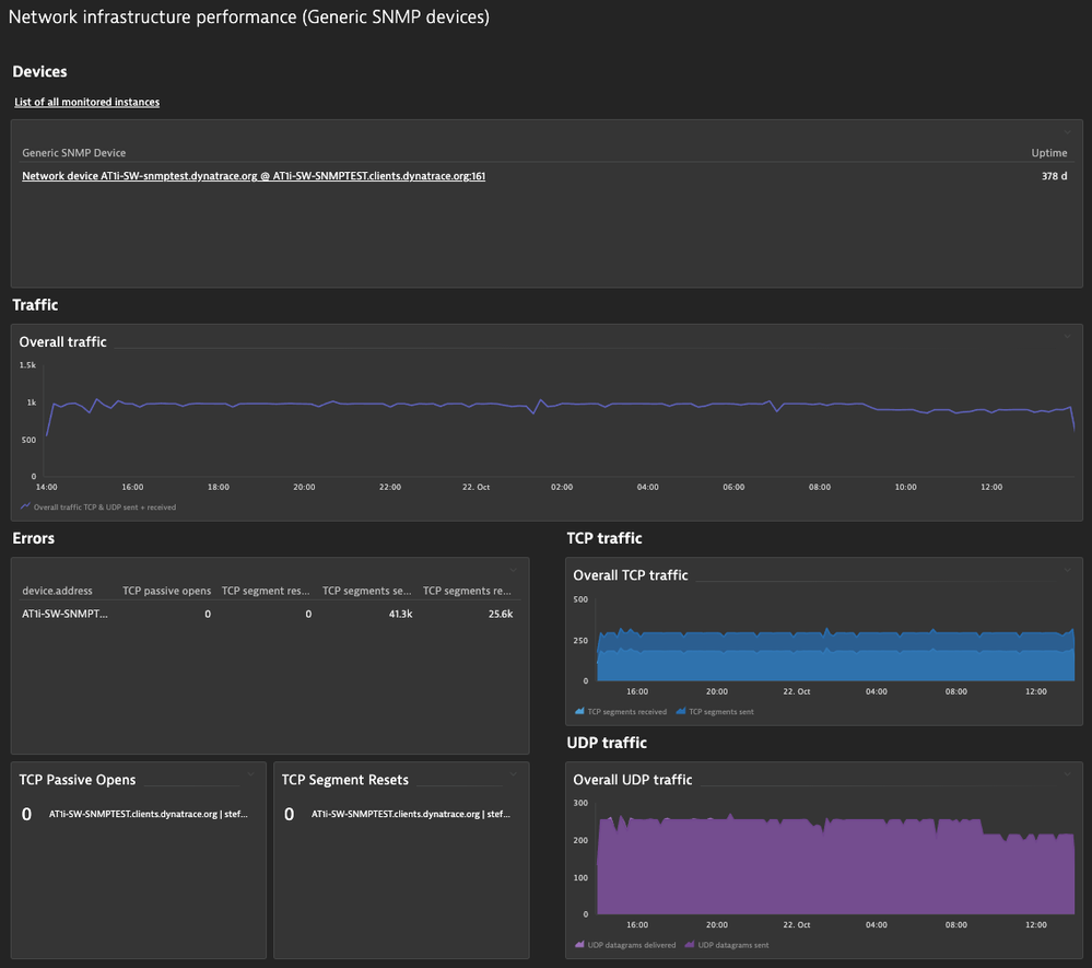

Hosts monitored via extension 2.0 no longer appear as a custom device, and therefore no longer in Technology.
You have to create a dashboard with the drill down capability to your 2.0 devices and its Unified Analysis page.
For example :
https://www.dynatrace.com/hub/detail/snmp-generic/?query=snmp#screenshots
To build your extension you can use https://developer.dynatrace.com/extensions-v2/dynatrace-extensions-vscode/ 🙂
