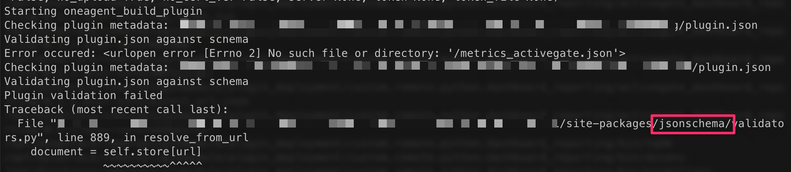

Depending on which version of the SDK you are using, you may see a Traceback message that references a problem in the jsonschema package. This is a dependency of plugin_sdk. There was a change made in version 4.10.0 of jsonschema that seems to have broken several tools that depend on it.
For now, the best course of action is downgrade your version of jsonschema to <=4.9.1. Run the command:
pip install jsonschema==4.9.1
After the downgrade is complete, try running the build command again. Here's an example of the error, the downgrade and a rerun of the build command:

02 Sep 2022 12:04 AM
Thank you for your answer.
I will try your solution, but in the meantime i made some progress.
As strange as it my seams, I've created an empty json file 'name.json' that was causing the exception. Then it threw another exception that it was missing a file name 'units.json'. I also created this file, and finally it threw an exception that a file 'properties.json' was missing. I made a copy of 'plugin.json' and renamed it to 'properties.json'.
After this changes i was able to run de simulator , build the extension and uploaded to Dynatrace compiled with the latest version of python 3.10.6.
02 Sep 2022 11:15 AM
Thank you.
I have applied your solution, downgraded the jsonschema and it worked.
