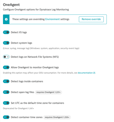

You can do it. You have to enable Allow OneAgent to monitor OneAgent logs in the host settings :
Then add the path to custom log source configuration (https://www.dynatrace.com/support/help/observe-and-explore/logs/log-monitoring/acquire-log-data/log-...) and storage configuration (https://www.dynatrace.com/support/help/observe-and-explore/logs/log-monitoring/acquire-log-data/log-...).
But be careful oneagent log is verbose 🙂 #DDU
