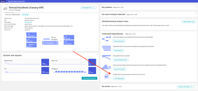

I'm trying to enrich my Fargate logs with the `dt.entity.process_group`. The end goal is that I want my team to be able to view all logs related to a service.
Here is a screenshot of the feature I'm trying to use:

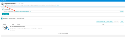

 And when I click the link above, I expect to see logs associated with my process group:

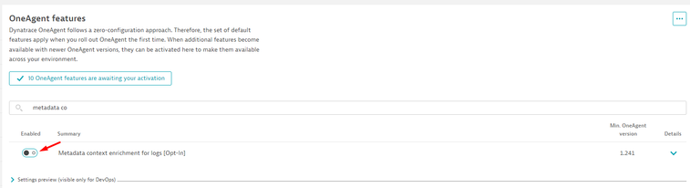

This is expected by default since Fargate deployments are app-only and there is no Log Agent deployed (like it is with full stack deployments). Try enabling this OneAgent feature (it should start adding the process group metadata to the logs) to see if you get any better results
This change does require a restart.
