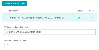

16 Jul 2026 09:53 PM
In SNMP trap extension, edit monitoring configuration for the related devices, in the list of endpoints expand the corresponding endpoint, scroll to to bottom and click Add varbinding, set these values:
OID Prefix: SNMPv2-SMI::experimental.94.1.11.1
Number of octets trimmed: 17
