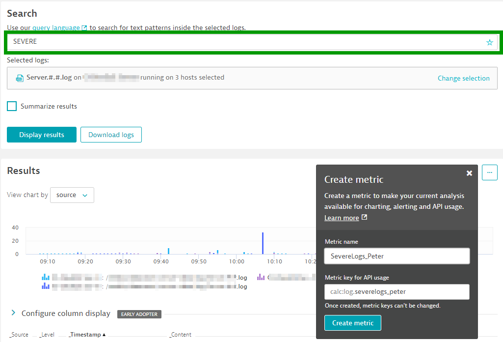

It is currently possible to subscribe a custom metric based on the occurrence of log messages matching a specific query. Therefore a metric like this can be created:
The metric will show the count of of loglines matching the "SEVERE" query split by Log filepath and Process. Currently it is a contains() search so there might be false positives as "SEVERE" could also appear somewhere in the log message. That will be enhanced in the future by adding dimensions to the metric such as the log level, which will then omit false positives.
So to achieve your use case, two metrics would be needed. One counting loglines matching "ERROR" and an additional one matching "WARNING". Of course these metrics are available for charting and dashboarding.
The logfiles intended for this monitoring use case have to be stored within Dynatrace as a precondition.
