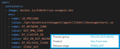

You can try to use environment variable DT_CLUSTER_ID=process-1 to skip all built-in \ additional user defined rules.
We use this approach in k8s - to have no set of rules in the interface and to be able to manage the name of the process group from the yaml manifest by application\infra team.

DT_NGINX_ALL_WHITELISTED=1
@Romanenkov_Al3x, thank you for the response.
Where I can find the variables that are passed, does it show anywhere on Dynatrace console or I have to look into kubernetes.yml?
I'm observing some 'Kubernetes annotations' at process group instance level, can we make use of that in detection rule?
