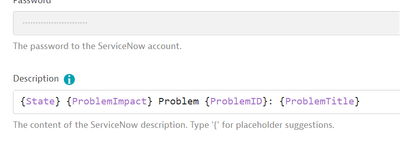

Is it possible to capture instance ID of a pod in the problem notification description? If yes how can I do so? For context, this is where I want to be able to add it

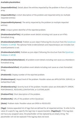

There are a few default placeholders available for problem notification. You can add these:
Could you check if there is enough information in f.e.
{ImpactedEntities}: Details about the entities impacted by the problem in form of a json array.
{ImpactedEntity}: A short description of the problem and impacted entity (or multiple impacted entities).
Otherwise try:
{ProblemDetailsJSONv2}, this will contain evidenceDetails. You should verify how this arrives in ServiceNow though.
