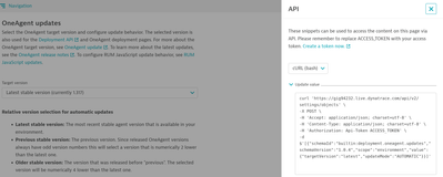

On the page where this message appears (I have the same one) there are also 3 dots above with a menu:
It shows that I should be able to use settings/objects API and also I can see the schemaid:
curl 'https://<MY_ENV>/api/v2/settings/objects?schemaIds=builtin%3Adeployment.oneagent.updates' -X GET -H 'Accept: application/json; charset=utf-8' -H 'Content-Type: application/json; charset=utf-8' -H 'Authorization: Api-Token <MY_TOKEN>'
{"items":[],"totalCount":0,"pageSize":100}
Unfortunately I don't have any resulta. In the API page there is only POST example, but explanation says that I should be able to access this page content by this API:
So shouldn't this API return the required information(e.g. the update problems if there are any) with correct get parameters (I supposed that schemaids should be enough, but seem that I'm wrong)? Please help me understand what I'm missing here?
