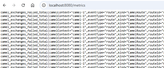

I have a Camel Quarkus application, and I can successfully view the Camel metrics at http://localhost:8080/metrics.
I’m using the Prometheus extension to expose the /metrics endpoint, and Micrometer to collect metrics.

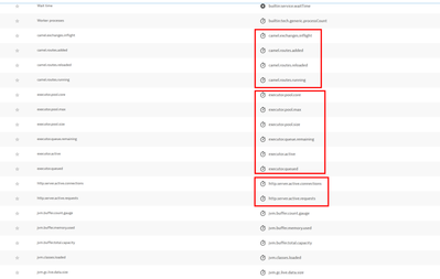

Despite this, I do not see any of the Camel-specific metrics in Dynatrace in the Metrics or Data Explorer section.

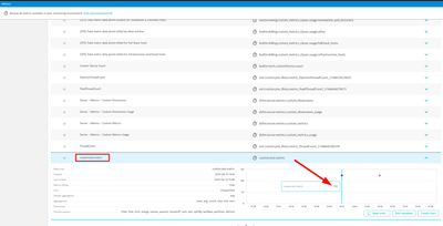

I tried the Metrics API to send Metrics to Dyantrace and it worked :
curl -L -X POST 'https://{environmentid}.live.dynatrace.com/api/v2/metrics/ingest' \
-H 'Authorization: Api-Token dt0c01.DFSFSDF324243.TESTSGDGFSDGDSFGDSFGDSGDSFGDSFGD' \
-H 'Content-Type: text/plain' \
--data-raw 'custom.test.metric 123'
Then I was able to see the metrics in the "Metrics" section.
Goal is to send metrics (Camel metrics) from my Camel Quarkus application. That is not working unfortunately.

I was able to resolve my issue.
Camel Quarkus Micrometer metrics can now be viewed in Dynatrace.
I fixed the issue by upgrading Quarkus to the latest version 3.23.4
