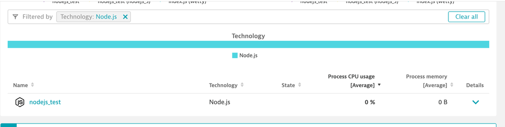

If I understood correctly, you want to see all four processes in four different process groups. If that’s correct, you can achieve it using a simple detection rule. For this, you need to use a proper environment variable to identify each process.

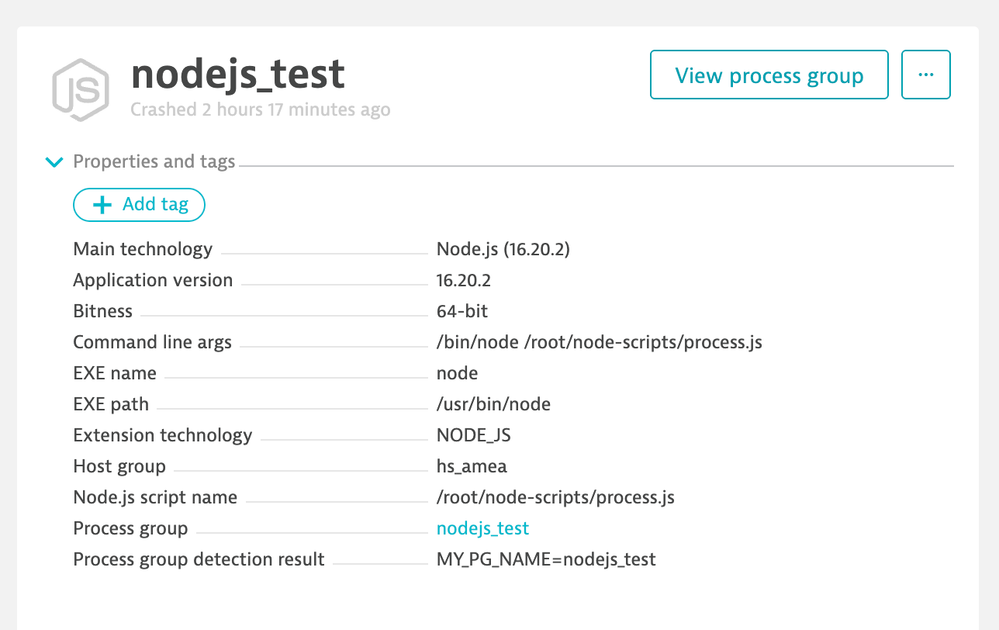

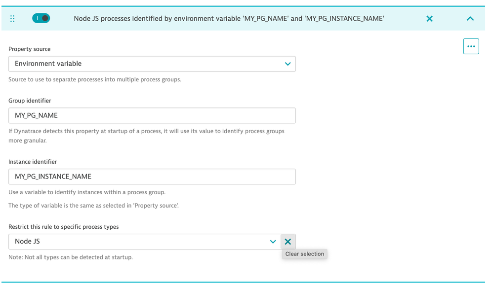

In my case I have added  below  variables and started the service . I could see expected result here.
export MY_PG_NAME=nodejs1
export MY_PG_INSTANCE_NAME=nodejs_1
Screenshot 2025-07-01 at 8.31.48 PM.pngScreenshot 2025-07-01 at 8.32.11 PM.png
here is the document : https://docs.dynatrace.com/docs/observe/infrastructure-monitoring/process-groups/configuration/pg-de...
If you do not explicitly define the rule, Dynatrace will detect all these processes as a single process group and its instance. It will then treat the other processes as worker processes under that group.
!!! Dynatrace !!!

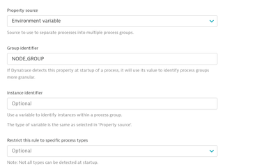

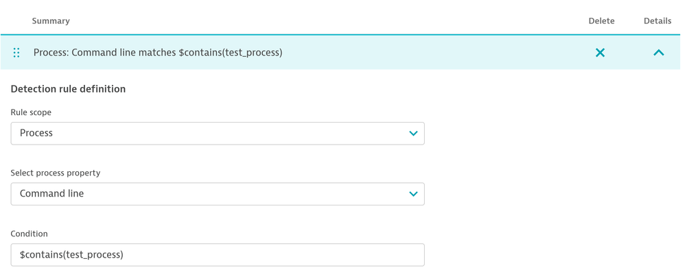

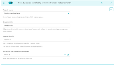

No, I want to see them in one group.  I followed the same document and I have simple and advanced detection rules (there are screenshots in my first post ). That is why I  have this line in service definition: "Environment=NODE_GROUP=nodejs-test" and in my simple detection rule I'm using environment variable and I have group identifier "nodejs-test".

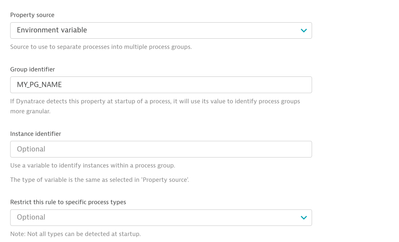

Hi @gencheva
I think there is a small error in your simple detection rule. Usually, in that configuration, you should provide your environment variable key as the group identifier [ which is NODE_GROUP ], and Dynatrace will use the value of this key as the name of the process group. and app process as its workers .
!!! Dynatrace !!!

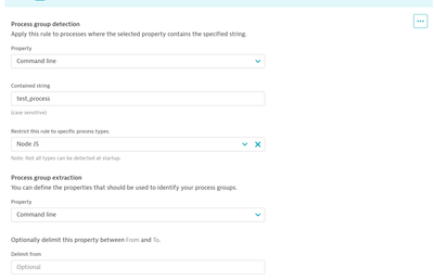

I tried to change it:
and also removed the other two rules - advanced and availability, but the result is still the same.
Hi @gencheva ,
Have you restarted the Node.js process after making this change? I replicated the exact same scenario as you and got the expected result.
Screenshot 2025-07-02 at 12.24.39 PM.pngScreenshot 2025-07-02 at 12.24.56 PM.png
Started the service using  below command
export MY_PG_NAME=nodejs_test;export MY_PG_INSTANCE_NAME=nodejs_1;/bin/node /root/node-scripts/process.js &
export MY_PG_NAME=nodejs_test;export MY_PG_INSTANCE_NAME=nodejs_2;/bin/node /root/node-scripts/process.js &
export MY_PG_NAME=nodejs_test;export MY_PG_INSTANCE_NAME=nodejs_3;/bin/node /root/node-scripts/process.js &
Not sure what's going wrong
!!! Dynatrace !!!
Thanks!

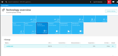

Hi @gencheva ,
Since you’ve conducted many experiments, Dynatrace has already created some process groups, which will remain in the historical data and can be ignored. At the top, there’s a time picker and please select the last 10 minutes or so and check which process group is actively delivering metrics. You can ignore all the inactive ones. after your change you should  see only one active process group and that have data. Can you confirm that ?
!!! Dynatrace !!!

Hi @gencheva
I think this is an excellent result . You can see only one process group based on the environment variable value. Within this process group, you’ll likely see two process instances — one for Earth and one for Arial. If you’d like to see two separate process groups, there are a couple of ways to achieve that:
- Use a unique environment variable for each host process — for example, on the Earth host: MY_PG_NAME=nodejs_test_earth, and on the Arial host: MY_PG_NAME=nodejs_test_arial. This will result in two distinct process groups as shown in the screenshot.
- Alternatively, you can use a unique host group for each host. This will not only separate the Node.js processes but also group all processes by their respective hosts.
Wishing you a great learning experience! 🙂 !!

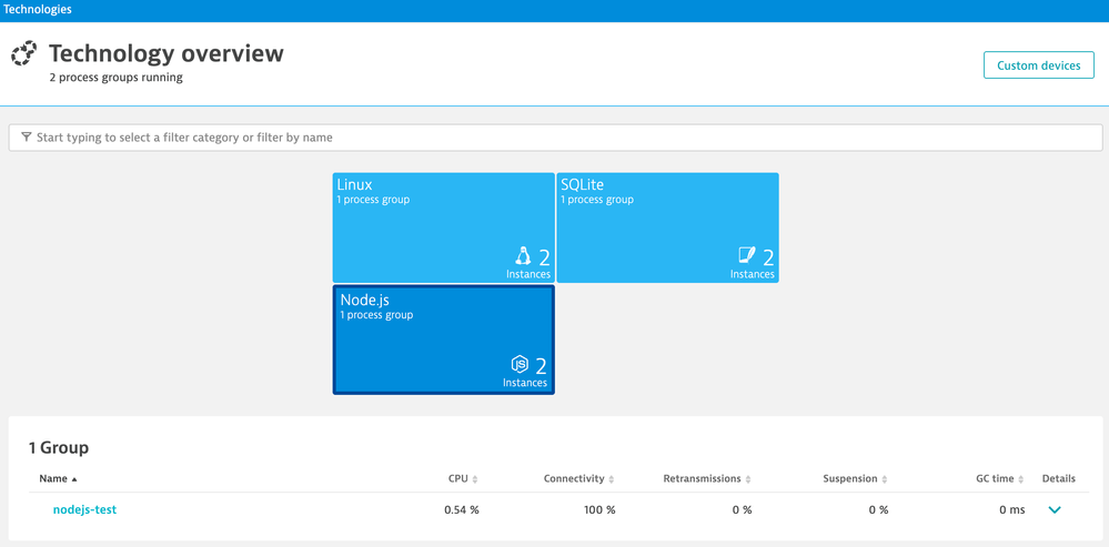

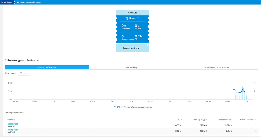

Hi @gencheva ,
If you follow the instructions, you should see something like this:
One process group:
Two process instances — one for each server
If you’re not seeing this on your Arial host, please make sure the OneAgent is active, and that Node.js is properly installed and running.
!!! Dynatrace !!!
Yes, this is what I'm trying to do.
