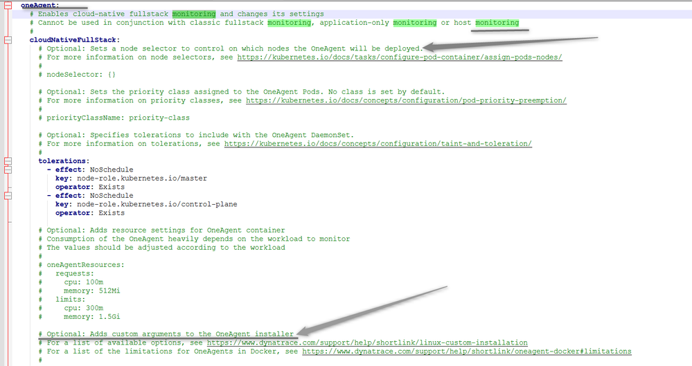

If you're seek adjusting the Dynakube.yaml, here is the attached portion where you can specify it with K8s team, would be much better to tailor the Dynakube as per the actual k8s setup.

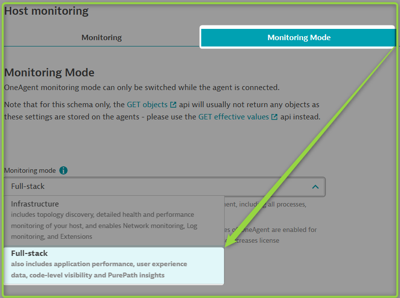

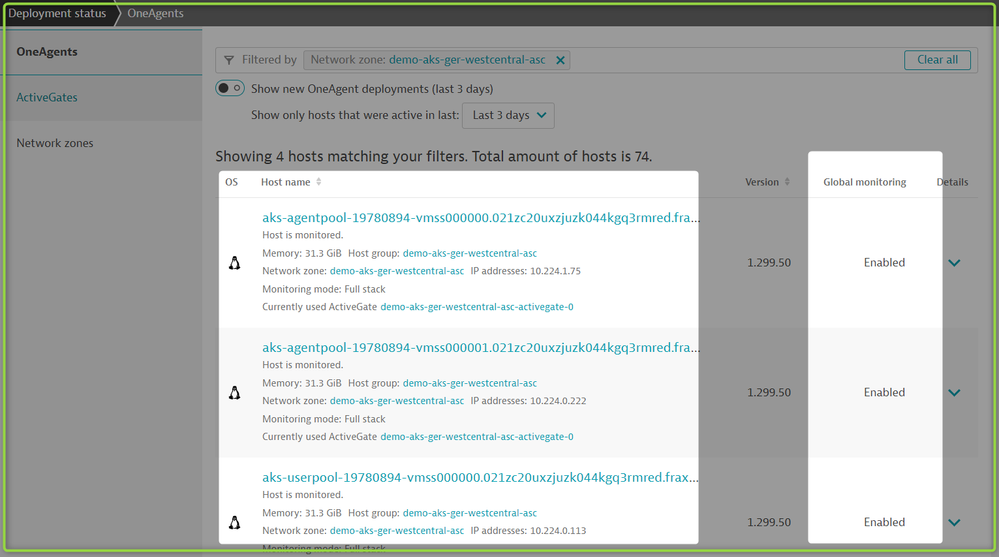

Dear @agylpradipta ,
if you go to the deployment status, you will find the master, worker nodes there. you can edit the hosts and switch to infra mode only. similar to any VM or normal host.
RB

Hello @agylpradipta
As simple as possible, Open under Dynatrace operator
As per the hostmonitoring.yaml you can customize the monitoring configurations for the K8s entities.

args:
- --set-monitoring-mode=infra-only
