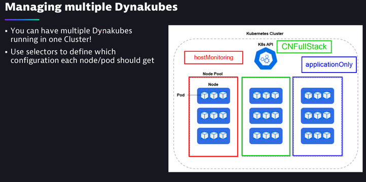

Now, in a regular Linux VM environment, it’s easy to choose the mode—whether full-stack or infrastructure-only.
But in Kubernetes, when using cloud-native full-stack, is there a way to set the database-specific nodes as infrastructure-only?
Is there any configuration either in the Dynatrace operator or in the dynakube.yaml file that can be adjusted to fit this scenario?
Thanks in advance.

Hi @agylpradipta
If you're seek adjusting the Dynakube.yaml, here is the attached portion where you can specify it with K8s team, would be much better to tailor the Dynakube as per the actual k8s setup.
2024-10-09_11h34_14.png BR,
Peter.

Peter_Youssef
Champion

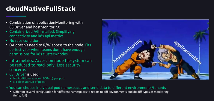

Hello @agylpradipta
As simple as possible, Open 2024-10-09_14h00_11.png under Dynatrace operator
As per the hostmonitoring.yaml you can customize the monitoring configurations for the K8s entities.
